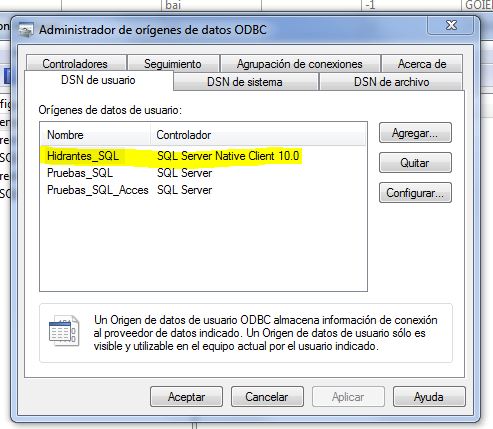

Some test after (sorry for screen copies in spanish Windows and Map):
- I see there are two ODBC Administrator, one for 32 bits applications (Windows\SysWOW64) one for 64 bits applications (Windows\System32); bizarre folder locations
- Using second one I can configure ODBC sources from SQL (see ODBC AD.JPG)
- Data connect in Map can access to these sources and read numeric columns as X and Y values (see Map data Connect.JPG, in the next post)
- I can add a Layer as always from that connection (see Map Layer.JPG, in the next post)
Some extra steps importing Access o Excel in SQL Server, but it works

Message 14 of 19
I think that works this way:
- Using any ODBC Administrator (32 or 64 bits) you can see the same ODBC user sources
- Using ODBCAD 32 bits you can define ODBC sources from Access, Excel, ..., and these can be used ONLY in 32 bits applications (like Map 2009)
- Using ODBCAD 64 bits you can define ODBC sources ONLY from SQL Server, and these can be used in 64 bits native applications (like Map 2010-64)
Working, of course, a 64 bits system (XP, Vista or W7)
