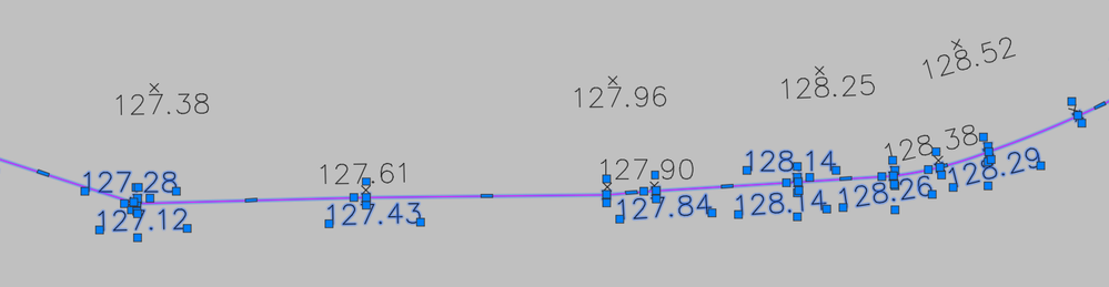

hello
how can i select only the objects\blocks that are conected to certain polyline from an entire drawing
like the objects on the poltlive vertex
i am using autocad 3d map 2015

i attached two files
for example i want to select a spesific polyline....(in my case all polylines) with the blocks that are connected to it.....but only the blocks on that polyline!

Thanks for posting your drawing and screen shot.
All the blocks are on the same layer, so I don't see a way to select only the blocks on Polylines. Maybe someone here will come up with something useful.

Try the FS command (from Express Tools).

IT WORKS
THANKSSSSSSSSS
EXPRESS--->SELECTION TOOLS----> FAST SELECT

Wow, Fast Select really seems to work! Thank you. I learned something new this morning.

parkr4st
use map FDO abilities
qselect the block and mapexport to a point .sdf with block attributes to data
Qselect the lines and mapexport to a polyline .sdf line attributes to data
put the line.sdf in a map and create buffer a very tiny amount such as .01 to new  .sdf
put the buffer and points into a map and mapgisoverlay intersection of points and the buffer polygons
the result is a complete data set of all the lines with the points in the buffer which being minimal is essentially 100% correct.
you can then theme that data set such as the .layer file
and Alexander,  FS is very handy.  thanks

Now I noticed that for FS there is an option FSMODE:
Command:
Command: FS
Use 'FSMODE to control chain selection.
FSMODE = OFF
If you specify "On", all line prolongation and all intersecting objects are highlighted.
