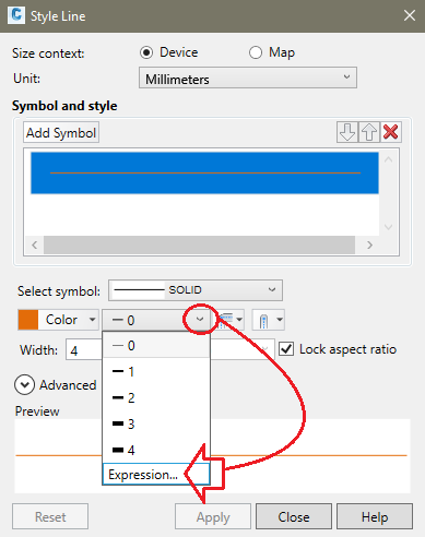

Hi, I am relatively new to AutoCAD Map3D. I am drawing up a site plan using map3D and I want to show contours of the site on the plan. I have an SHP file of the site contours and I have successfully connected that data to the workspace. This issue I am having is that I would like to make the contours partially transparent so that they don't stand out too much on the plan. I have been able to do this successfully when creating similar plans in QGIS but I can't seem to find a way to do it in map3D. Is there a way to do this in map3D? If not, is there a workaround or a way to convert the data to a different format where this can be achieved?

Hi @enquiriesVS3EM
Sorry, but there's no transparency setting for lines.
<<You can, however, control the transparency for hatch/fill that you use for polygons. For example, polygonal black building footprints with hatch. You can make the hatch/fill that's inside the footprints transparent.>>
Here are two options to make your contours WHISPER instead of SHOUT.
Option 1:
Use an EXPRESSION. See image-1. Your contours are using the default value for line thickness which is 0. Change the thickness value to 0.11 so it will be thinner=>OK. See image 2.
Image-1Image-1
Image-2Image-2
<<You may need to edit this expression later by increasing or decreasing the value, if you find the thickness is not suitable.>>
Option 2:
Change the color of the line to gray. See image-3. You can use trial-and-error method by choosing from the column of gray circled in red. Using something lighter than black will make the contours less dominating.
