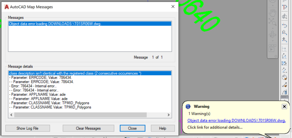

I attached and queried the T01SR06W drawing into T01NR06W. Got a strange "warning", but mostly the query seemed OK.
