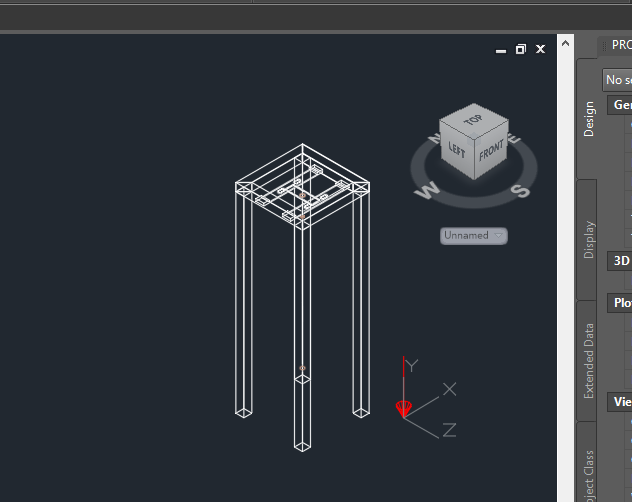

I've screwed up the xyz somehow. If I click Top it shows the top, If I click Bottom, it shows the bottom, but if I select a view like SW Isometric, the thing is lying on its side. If I rotate it 90 degrees, then Top is not top. How do I fix this?

So you've drawn small stand (or table) with four tall, skinny legs. You want the stand to be upright and not laying on its side, correct? If that's what you want to do, then try this:
  1. Go to Viewcube=>FRONT. Image-1.
  2. View Tab=>Views Panel=>Select FRONT from dropdown menu. Image-2.
  3. On command line enter ROTATE=>Use crossing window and select all objects=>Base Point: 0,0=>Rotation Angle: 90. Image-3.
  4. Go back to View Tab=>Views Panel=>Select TOP from dropdown menu. Image-4.
  5. Go back to Viewcube=>SW view. Image-5.

For step 3, I don't know what "crossing window" means, so I type ALL and that seem to work.
Thanks!
