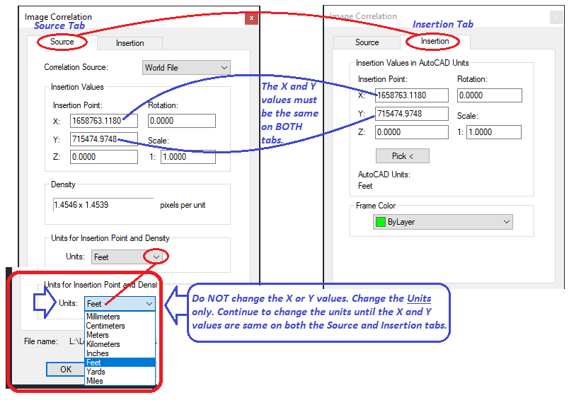

2. Then, once the appropriate CS is assigned, you may run MAPIINSERT command. Follow the notes shown below. Refer to image-2. Do not mix other instructions with these notes--follow them e-x-a-c-t-l-y.
Image-2Image-2

I appreciate you looking into this but the coordinate system is not the issue.   Attached are what my mapiinsert dialogs look like after assigning the coordinate system.   Setting the insertion units to inches puts it in the right place, but as you can see I do not have the option to pick a world file and i need to have that option.  As I explained in another post here, it relates to where the images and world files are located.  On my local drive 2026 can read the world files, but on a network drive it cannot.
