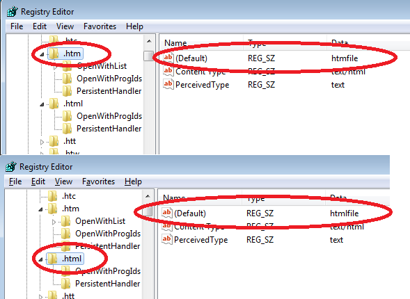

If you are comfortable editing the registry, you can try this.
Open the registry editor
Navigate to "HKEY_CLASSES_ROOT"
Navigate to ".htm" and ".html"
The top (default) value for the .htm version should read "htmfile" and the top (default) value for the .html version should read "htmlfile"
If it does, try changing these values to "ChromeHTML" for the default value in both the .htm and .html fields. This should set Chrome as the default browser in the registry.  From what I gather, sometimes setting your default browser through the browser itself does not correctly change these values.
Below are some sample images.  As always, USE CAUTION when editing the registry.  Maybe take a screenshot of your original values to make sure you can go back to them.  I tried this based on the Autodesk article >>here<<  I can confirm that changing these values did cause the "browser" command to launch the correct browser, but I have not done extensive testing of any other systems.
I can also confirm that using the chrome "make default" command as well as the firefox "make default" command edited these values correctly, while the IE "make default" command did not.
Settings with IE as the default browser:
Settings with Chrome as the default browser:
