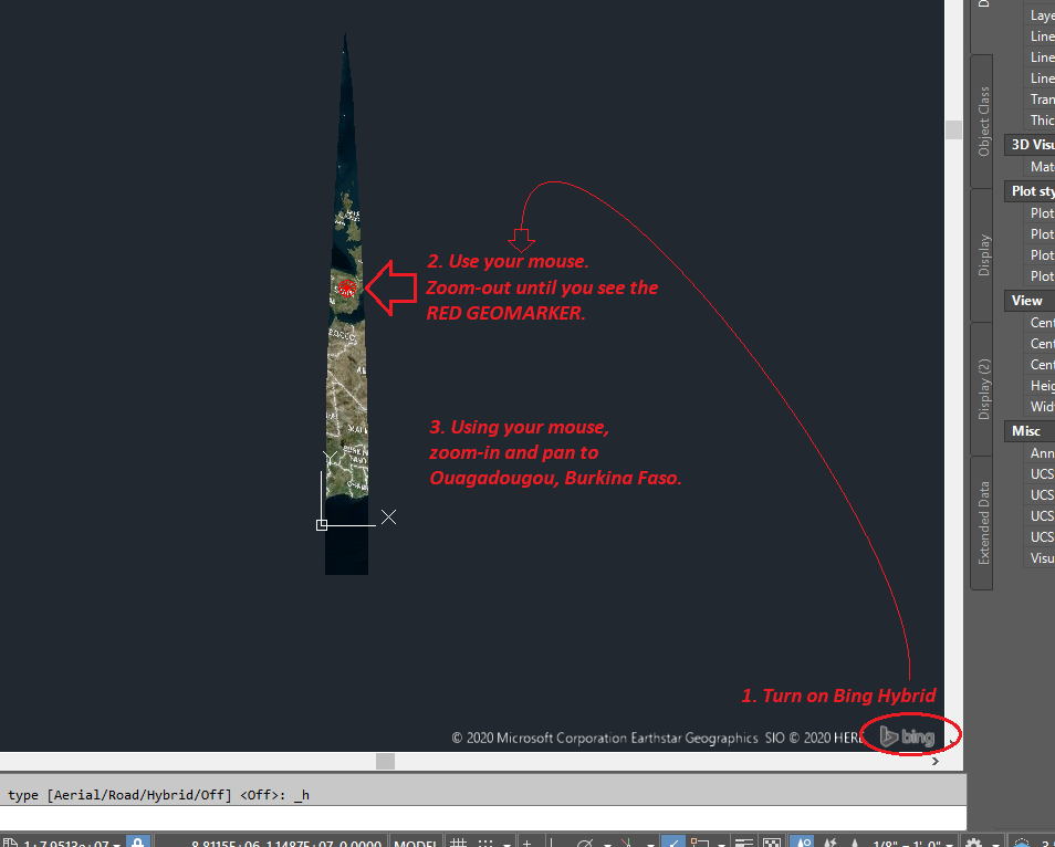

Open a new, clean metric template and follow the steps below. This new template should not have an assigned coordinate system.
  1.  MAPCSASSIGN on command line. Search for UTM84. Scroll down and select UTM84-30N, click ASSIGN button.
  2. Go to Geolocation Tab=>Online Map Panel=>Map Button=>Select Bing Hybrid. The Bing Logo will appear in lower right corner of modelspace. The logo indicates you have successfully 'connected' to Bing online imagery.
  3. Using your mouse, zoom-out and pan until you see the Red Geomarker. (The geomarker indicates a coordinate system has been assigned to modelspace--Map3D doesn't ascertain whether the assign CS is appropriate, it merely indicates that a CS has been assigned.)
Image-1.Image-1.
Image-2.Image-2.
Image-3.Image-3.
You may now use your mouse to zoom-in and pan to Ouagadougou, Burkina Faso. At this point, you may, if you wish, turn off Bing Hybrid.
