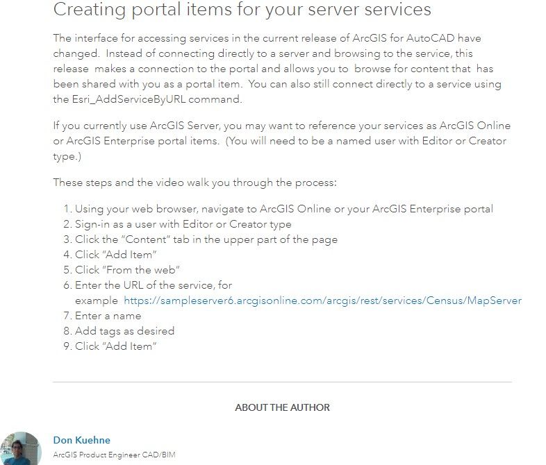

I'm loss for words......have you tried this?
You can read about it >>HERE<<.
