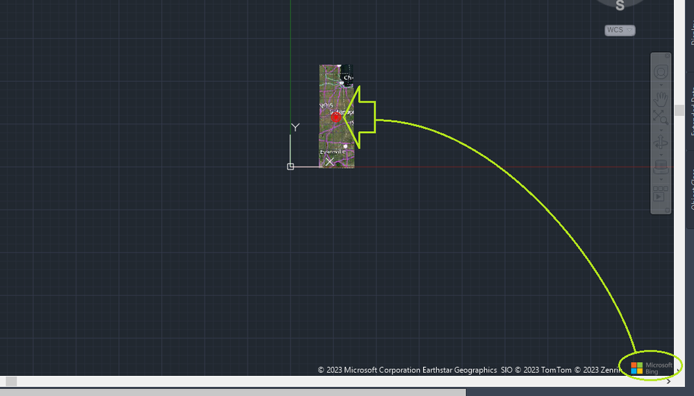

3. The Bing logo that's displayed in the lower right corner means you have a valid internet connection to Bing Maps. If you don't see the logo, Bing won't be available to use as a basemap in your drawing. The red geomarker (looks like a red bicycle wheel with red spokes) is the center of your 'assigned coordinate system' and the online map you've just added extends a little beyond the extents of your assigned CS. (That's why you need to 'assign' the correct CS.....because if you assign the wrong one, your imagery won't be in the spot you really want.) You may need to zoom-out to find the geomarker in modelspace.  Once found, you can use your mouse to zoom and pan to navigate to your site using Bing Hybrid labels as your guide.Image-3Image-3

  4. Does Geolocation tab appear in the ribbon? Turn on Bing Hybrid=>Zoom extents. Where are you?
Chicagolooper
Message 20 of 27
cwkbpa
Hi @ChicagoLooper ,
When we do that on the Map3D 2024 the red cartwheel is 58669.2233 to the south west of the circle.
Location:
x: -56083.6090
y: -17225.1721
I did not get any aerial photography or streets map to view after zooming out very very far.
I will add that there is another person in a different thread asking for help on this same problem.  He is using Civil 3D.  AutoDesk has escalated my issue to Licensing, Development and Business management departments.
