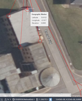

The file I have been provided uses OSGB1936.NationalGrid. When I follow the steps provided, the points don't scale correctly.

Hi Archie,
"Expected: X = 53.9122, Y = -0.1618
Actual: X = 564555108.8295 Y = 432344676.6551"
I can't get these numbers to work. The X and Y look reversed, and even if the huge coordinates are millimeters, they still don't match. Need more information.
Dave
Dave Stoll
Las Vegas, Nevada
NVIDIA Quadro P5000 16GB
Windows 10 Pro 64 / Civil 3D 2027
Message 26 of 33
A_HULL-2021
Hi Dave, the top image looks correct, as I have placed the geo-reference on the top right corner of that building. I got them using the ID command to get CAD coordinates, then from looking at the “Geographic” coordinates on the bar on the bottom of the screen. I noticed the plotted points are very far away from the origin, which is more noticeable if I remove the CRS/geo-reference, as the screen zooms out to show the origin and the drawings, which appear as a small blob.
Other points are:
 564552146.4655, 432343333.6304 == 53,9001, -0.2069
564551071.3369, 432346530.5326 == 53.9288, -0.2233
What extra information do you need?

Pointdump
Archie,
"564552146.4655,432343333.6304"
These numbers don't belong to any coordinate system that I know of.
Use Command -DWGUNITS to check units. Map 3D is built on top of AutoCAD, but there is no error-checking if the units don't agree.
"1936 entities were skipped due to failed coordinate transformations."
If your drawing units are Millimeters, that would explain.
A Latitude of 53.9122 and Longitude of -0.1618 would be 124 Meters from that building corner, in OSGB1936.NationalGrid.
Dave

Pointdump
Archie,
Thanks for posting your drawing.
Someone has used the command GEOLOCATION on your drawing. That command is intended for Vanilla AutoCAD and usually wrecks a Map 3D drawing. Use command GEOREMOVE, then use MAPCSASSIGN to re-assign EPSG:27700 to your drawing. When you zoom out you'll see how wildly out of the extents of 27700 you are.
How to fix? I don't know. Even scaling by 1/1000 won't be "close enough".
