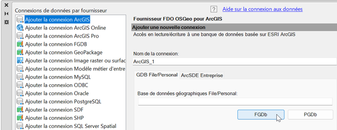

Actually, I've a licence ArcGis Standard with is used by AutoCAD Map 3D 2023 to connect to FGBd local file, through my plug-in (API of Autodesk GeoSpatial plateform).
ArcGis Standard stops support in 03/2026, and my reseller want to uprage to ArcGis Online Professionnel. He tells me that I should use Autodesk Connector for Arcgis to connect to FGBd, but I don't find any information on help. It seems it's necessary to publish data to portal ESRI Online to connect via Map 3D.
Is it possible to connect Map 3D to FGBd stored locally, via such new ArcGis licence? available with Map 2023 or necessary to upgrade Map 3D too ?
I'm not an ESRI user, I just need a licence to connect customer's FGBd via my Map 3D 2023.
Thanks for any thinning.

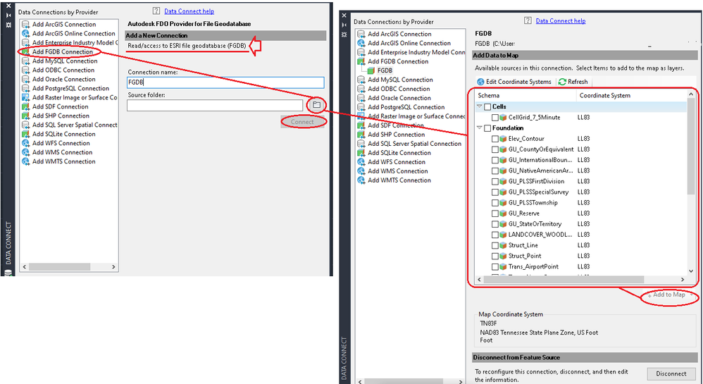

ChicagoLooper
You connect locally to File GDB like this?
Use MAPCONNECT to get the Data connect palette.

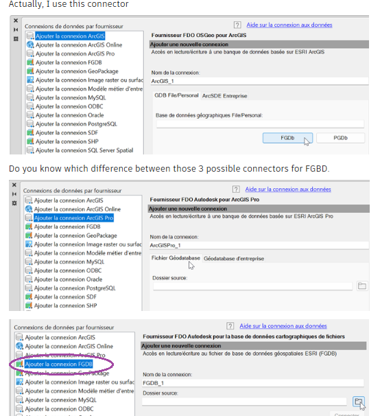

O_Eckmann
Hi @ChicagoLooper ,

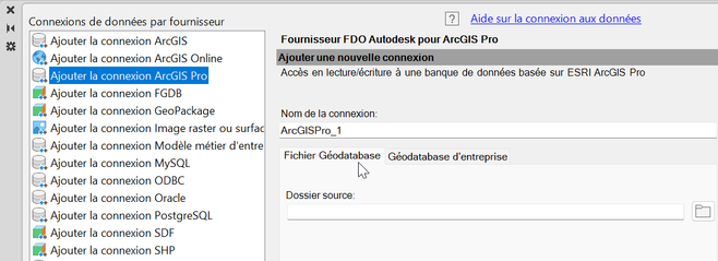

Actually, I use this connector
Do you know which difference between those 3 possible connectors for FGBD.
Olivier Eckmann

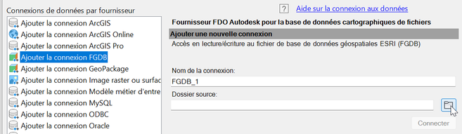

ChicagoLooper
@O_Eckmann
I don't have the same version as you......but if I'm saving the geodatabase locally on my hard drive I'd use the option on the bottom. I'm not familiar with the other two options.
Chicagolooper
O_Eckmann
OK, thanks @ChicagoLooper , I'm trying this option.
