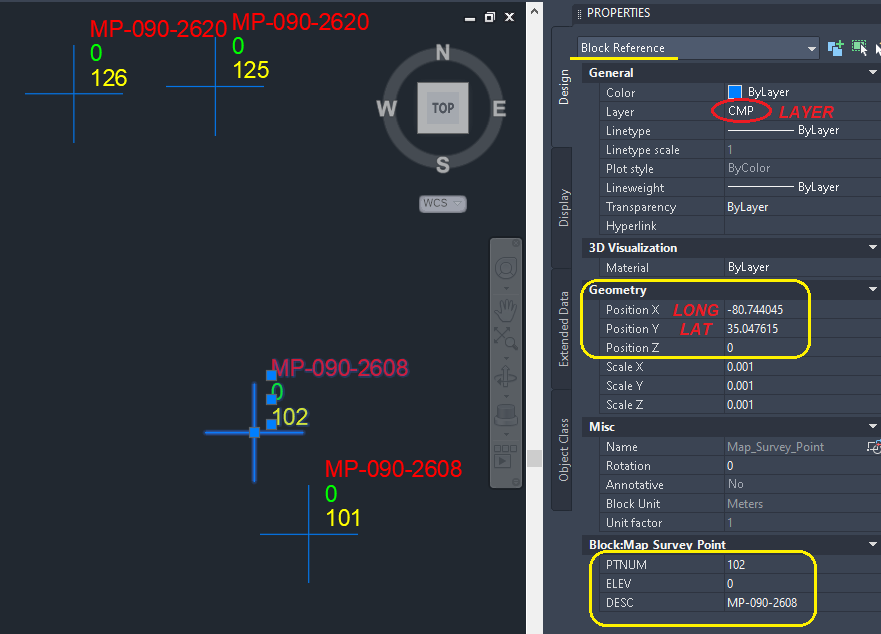

7. (Also Optional) In the Properties Palette, the newly inserted blocks will display X as Long and Y as Lat, easting and northing respectively. Long is always negative in North America and Lat is always positive north of the equator. See image-7.Image-7Image-7
