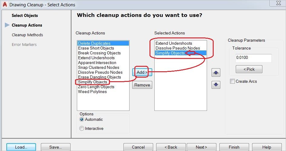

Your latest uploaded dwg file contained two polygons. According to the Properties Palette, one polygon was closed white the other was not. The were no gaps at the corners of either polygon.
You can add Simplify Objects to your existing Map Cleanup action list which will 'close' the polygon. Is a closed polygon what you want? If it is, then good. If not, you'll need to provide a better and more thorough explanation of what you're trying to achieve.
Add Simplify Objects to the  action list.Add Simplify Objects to the action list.
Chicagolooper
Message 11 of 19
Closed is what I want, but my problem is that there are some quite intricate features, i.e. with curves that require multiple vertices. When I simplify enough to close, they are also simplified and deformed? I've tried various parameters, but have not found one that closes, without significant distortion.

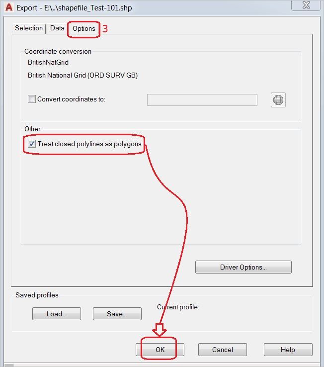

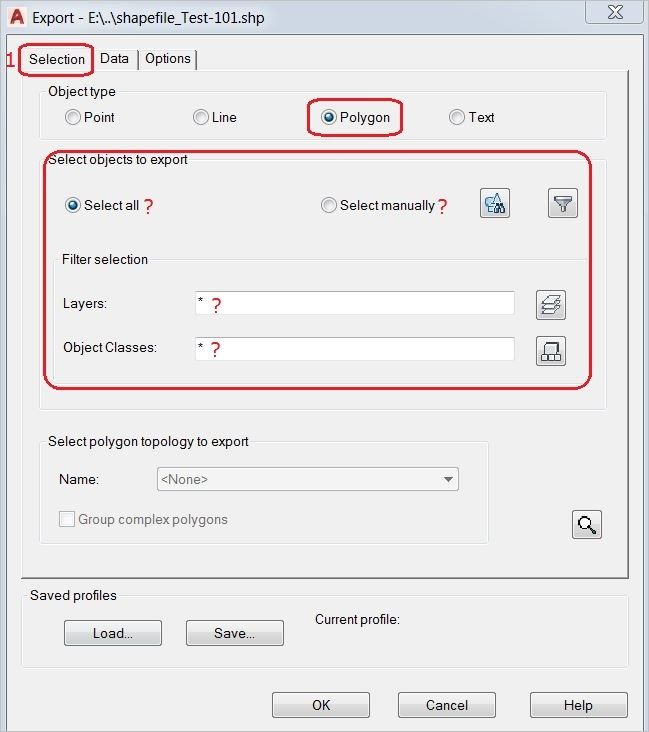

Thank you for providing the additional information. The issue is your title to the opening post. A more appropriate title would be, How do I Export AutoCAD Polylines and Polygons to Shapefile so All Resulting Polygons are Closed?
Regardless of whether the polygons are closed or snapped, you are exporting to shapefile.  The exported shapefile must be a vector such as a 1) polygon, 2) line or 3) point. (You cannot combine vector types so if you need to export all three types of vectors, you'll need to export to three separate shapefiles.)
Go to output Tab=>Map Data Transfer=>DWG to SDF button. In next dialog, change 'Files of type:' from SDF to ESRI Shapefile then Name and Save your shapefile in a folder.
In the Export dialog there are 3 tabs. Use the following to select your settings. If you use this method, you don't need 'Drawing Clean Up.' The key to accomplishing what you need is on the 3rd image, Options Tab.
1-Choose a method to select the entities for your shapefile.1-Choose a method to select the entities for your shapefile.2-You may choose attributes to populate the shapefiles's dbf.2-You may choose attributes to populate the shapefiles's dbf.3-Check the box labeled 'Treat closed polylines as polygons.'3-Check the box labeled 'Treat closed polylines as polygons.'
Chicagolooper
