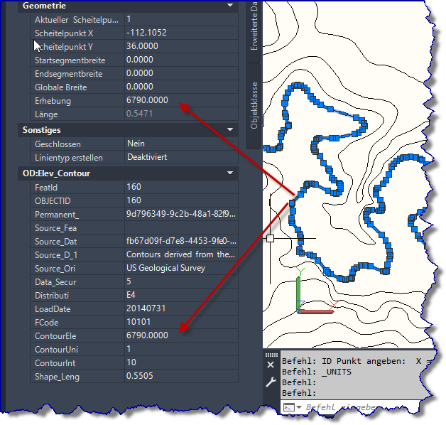

Alfred.NESWADBA
>> So here's the same shapefile
This is not a SHP-file, it's a DWG-file.
>> Do you see how there seems to be a scale issue in 3D?
Why is it a scale issue? What is different to your expectation?
This is what I see, polylines, having ObjectData attached and having an elevation set to the same value as the ObjectData's field "ContourEle"
- alfred -
Alfred NESWADBA
(not an Autodesk consultant)

axk5889
Thanks, Alfred.
So I didn’t explain that well. That file is a .dwg with the shape file data attached as object data.
The 3D elevation data should look somewhat similar to the attached screenshot. But for some reason, if you go into the file and view it in 3D the contours are sort of stacked and not displaying like terrain normally should. And I’m not really sure why?
Message 35 of 40

Pointdump
Alex,
"...if you go into the file and view it in 3D the contours are sort of stacked and not displaying like terrain normally should."
You didn't assign a coordinate system, so when you brought the LL83 shapefile into your drawing AutoCAD assumed the units were feet. They were really degrees, which is why your drawing "bunches up".
Dave
