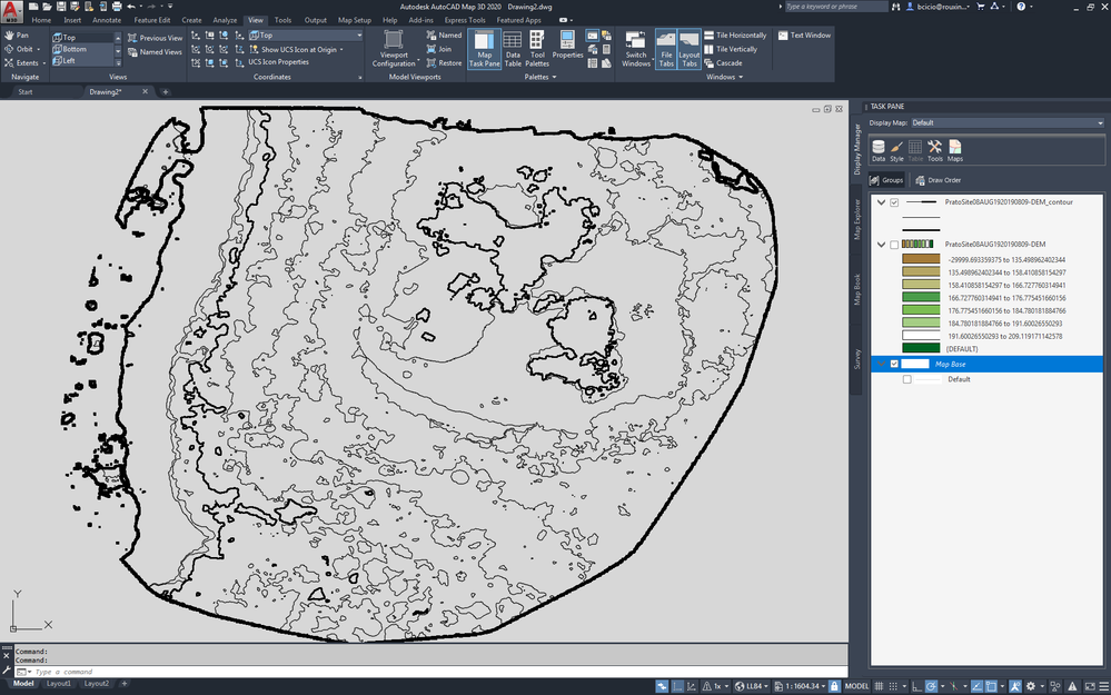

Admittedly, I do not know my way around Map 3D as I usually work in Vanilla AutoCAD.  I have connected the data and added a DEM.TIF file, but the .TIF appears to be a flat image even though I have added a color style to the various elevations and the colors do vary.  I can create contours, but even those appear to be all zero elevation when viewed from the front or sides.  However, as I rotate the object using the 3DOrbit command, I can see a 3D wire frame ghost image of a 3D mesh surface -- so there is obviously a 3D mesh that has been generated in the drawing.   When I exit the 3DOrbit command, it all goes back to just a flat 2D image.  So my first question would be how do I display that mesh?  And second would be how do I create 3D contours with elevation values based on it?  Interestingly, if I import that DEM.TIF into Civil3D, it tells me that the points have no z-values.  (But, again, Map3D shows a ghosted mesh during 3DOrbit).  Thanks for any pointers.  --BillAutoCAD3D-1.PNGAutoCAD3D-2.PNGAutoCAD3D-4.PNG

You can can topographic contours from your DEM in sdf format. The sdf format is a vector, not a raster. The sdf can also be imported so they'll be AutoCad polylines. As you can tell, obtaining usable CONTOURS from a DEM is a two-step process, not a simple click-and-I'm-done deal (usable means you can use them to create a surface).
To Create Contour Lines:
Right click PratoSite08AUG in the Map Task Pane then select Create Contour Layer from the shortcut. You'll be presented with options to select contour interval, major contours, elevation in feet or meters, and the folder where you wish to save the contours (in sdf format).
Using MAPIMPORT command on the sdf contours, you can then create, or convert them to polylines. Be sure to 'Create Object Data" during the import so your contours will have elevation 'data.' This data is important b/c it can be use to 'elevate' or raise your contours from z=0 to their proper elevation using the Query and Alter Properties functions.
By using QUERY and ALTER PROPERTIES functions together, the contours will be 'raised' and once raised can be used to build your surface. Back in August 2011, Brian Hailey did an excellent job explaining this procedure. You can read about it >>HERE<<.

@ChicagoLooper   Maybe I'm a little slow, but can you spell out how to use the Query and Alter Properties functions to change the elevation of the contour lines to match the object data obtained from MAPIMPORT?
jmorrison2Q85R
Looks like I found it myself...maybe a little more convoluted than I'd like.
