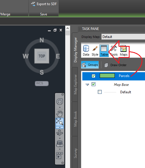

Would it be possible to upload a screen shot of your SDF's Table View. Adjust the width of the Table so the 'DATE COLUMN' is visible or show make the table wide enough to display all the columns. You don't need to make the table super tall, just tall enough to capture the top 6 rows.
