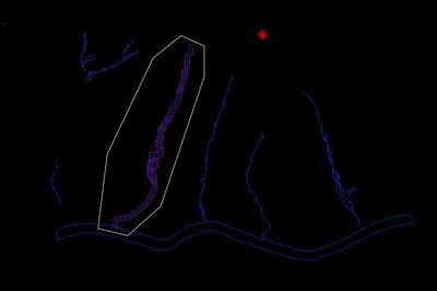

Greetings, I think I've run into the dreaded Hatch Boundary and Boundary Command unreliability issue so I'm hoping some one can suggest an alternative for what I'm trying to do.
This is a basic construction site plan and I need to apply offsets to various imported data.
1) A GIS contractor generates a DWG file with wetlands data.  The wetlands are often 3D polylines.  I flatten these using MAPCLEAN.
2) I apply an offset to the wetlands plines and draw an arbitrary closed pline around the area I'm interested in.
3) I want to use the BOUNDARY command to create a new pline at the maximum extents of the overlapping offsets.  This kinda works sometimes, but most of the time, it behaves unpredictably.  In this example, it finds the closed circular areas but not the (also closed) long skinny area.
I have also tried using HATCH.  The preview looks almost perfect, but then you click and it basically acts just like BOUNDARY.  (See below, preview, then finished hatch.)
I have copied this section out into a smaller DWG attached to this post.  The smaller file behaves the same way.  All plines are closed and non-overlapping.  Is there something I'm missing in the HATCH or BOUNDARY commands or is there another way I should be going about this?

You have to be very carful with boundary command because it reacts according level of zoom.
Here is a screen cast with your data, 1st attempt with zoom on entire window, and 2nd attempt with a very big level of zoom. In 2nd case, it's OK.
To avoid such problem, best solution is to create REGION of each closed polyline, and create an UNION of these REGION, then EXPLODE resulting REGION and MAPCLEAN to recreate enclosed polylines.

IMHO far easier to use a sdf file and buffer the objects
MAPEXPORT the wetland areas to a SDF file as polygons
apply MAPFDOBUFFERCREATE command selecting join all buffers and OK
Feature overlay analyse with symmetric difference and the result buffer area is that of the buffer area outside the wetlands.
Mapimport if you need cad objects

Thank you again.  Here's how I ended up getting this to work.
1) MAPEXPORT Wetlands Layers to SDF
2) Create SDF connection --> add to map
3) MAPFDOBUFFERCREATE based on SDF of Wetlands
4) MAPIMPORT (as closed polylines) the SDF of the buffer onto layer 0
5) Selected exterior polylines (very quick) --> moved to setback layer --> froze all layers except 0 --> quickly select and delete interior plines.
This is awesome, I really need to learn more about the Map3D toolset.
