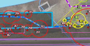

At first glance, though, I'm thinking FEATURE BUFFER and not just sizing the circles in the Style Editor. Feature buffer is where you indicate each tree's buffer (the buffer is the radius of the tree spread). Yes, each buffer analysis will give you the option to merge the overlapping circles provided they have same buffer value. You can only input one buffer at a time so it'll require you to perform a separate analyses for each radius or spread value. You can, however, create multiple buffers, where each buffer has a different tree spread e.g., Buffer 10, Buffer 20, Buffer 25, etc., etc.
After completing Feature Buffer, you can perform FEATURE OVERLAY. This analysis can look at the new buffer shape (the new shapes were created using the feature described in the paragraph above) then analyze to see whether the new shape, or tree spread, will interfere with the building footprint.
Here's a quick and crude illustration. I'm sure it can be fine tuned based on your requirements and your actual data.
Notes:
  1. Without sharing your data, there's no definitive way to answer your question and give you a play-by-play explanation outlining the procedure. Can you share your data?
  2. All objects shown in the image beloware shapefiles. AutoCAD entities don't have the horsepower needed to handle this kind of analysis. The red overlapping circle thingy was created by Map3D and connect where they overlap and are separate where they don't.
