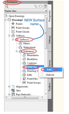

Hi @randyspear6624
If you are trying to build a tinn surface using Civil 3D, then use C3D. You don’t necessarily have to use Map3D if you’re starting with a DEM.
In C3D, create a surface in Toolspace. This entails establishing a name for a NEW surface. The newly named surface will merely be a ‘placeholder’ for a surface to-be-created.
For your surface, you’ll need to give it ingredients, or raw materials, so civil can build it. The materials are known as the surface definition. This is where you can ‘add’ your DEM as that surface definition.
Chicagolooper
