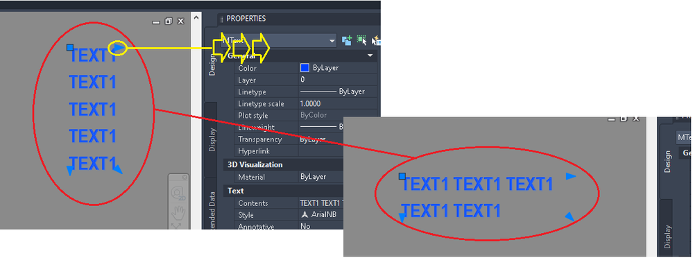

1. For example, you select 5 individual mtext objects. (The Properties Palette verifies it's 5 mtext objects.) Then, after clicking the Convert to Mtext button on the Ribbon............
2. .....hit Enter and the Mtext converts to a single object.  BTW, the command line also verifies 5 objects were selected.
3. The result is as expected....the conversion makes a single Mtext object.
4. At this point you can drag the upper right blue grip to the right. This expands the mtext width so the initial 5 lines reduces down to 2 lines. And it does this without deleting any of the original text. Why does expanding width reduce the number of lines? Because it's one Mtext object, not 5.
