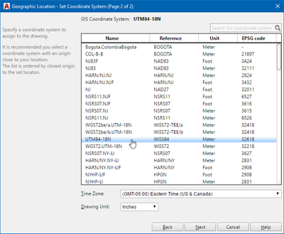

Hmm... I figured that in my GEO command in regular ACAD I have to choose a datum so I just assumed that process was setting the CS:
Either way, your previous reply is great - I'll give it a go when I get a little free time, so thank you so much!

Hello @oiverson
FYI, if your site is in the US and you assign UTM84-18 to your drawing, you'll be drawing in meters, not feet. Meters, as opposed to feet, will mess up your viewport scale, unless of course, you really and truly want to draw in meters.
I'd suggest you draw in State Plane with units of feet. Just curious, UTM84-18 covers the states NC, VA, NJ, PA, NY, to name a few. What is the site's nearest major city/state? Or county of the site? The county (or city) will determine the State Plane and Zone to assign to your drawing.
