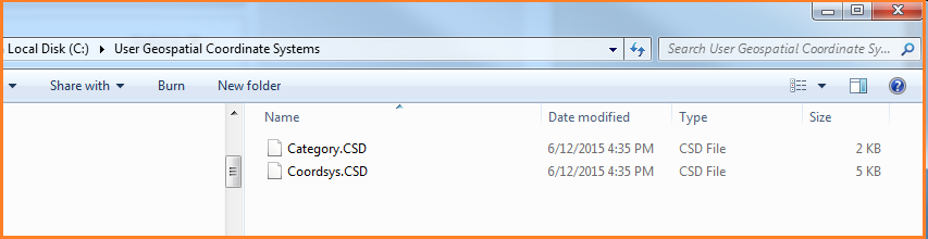

I pulled these two files out of my User Geospatial Coordinate Systems Folder, but they just magically re-appear, and my Library is still blank:

OK, now I deleted, instead of just moving, those two files. That seemed to work. I'll play with it further, but I think you definitely put your finger on the problem.

Wow, can't imagine why that happens .... ahh one option maybe: have you had opened (during the tests) a drawing with a user specified coordinate system? ...(so Map 3D checks that coordinate system in the drawing as "unknown" and so stores the definition again in the user coord folder.
