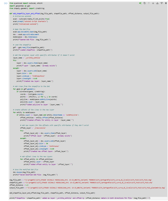

Hi there,
I was trying to access autocad from python and could not load due to a windows error.
I was trying to access the file, then add a layer. Than based on the added layer create an offset into both directions. Make a new layer for the offset of the line. And then write the autocad file to a new file. Right now I get an error, I tried to move the registry key from local machine to current user, but it seemed like that it did not solve the problem. Do you know what could be the problem?

Managing Geospatial API with python isn't very easy. (generally speaking, managing AutoCAD with Python isn't the easiest way).
Perhaps, you could look at this blog : https://pyarx.blogspot.com/2023/09/geopandas-with-python-and-autocad.html
