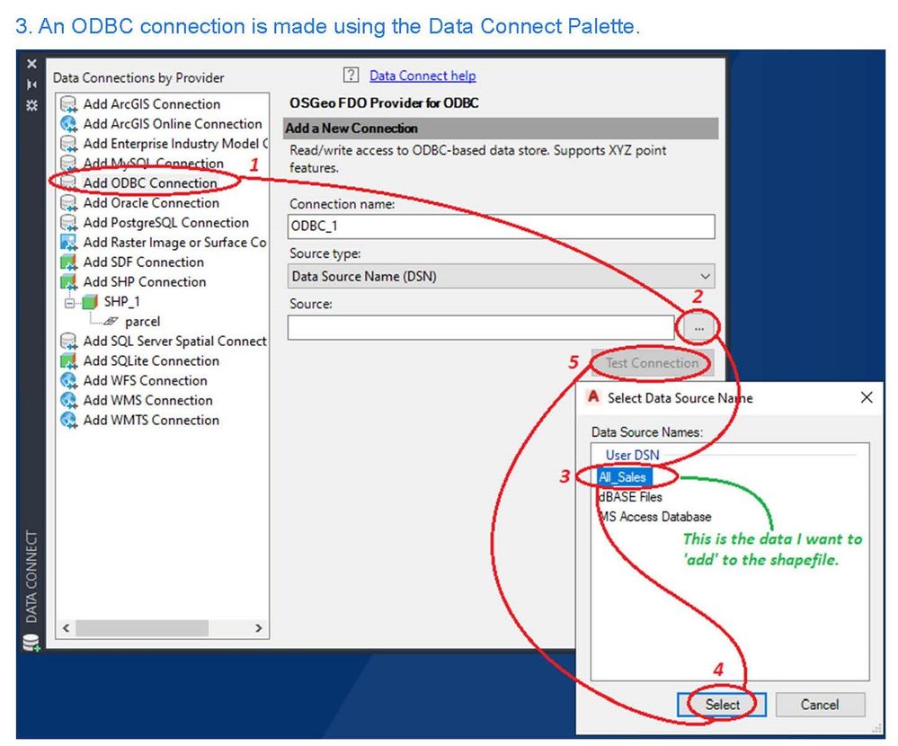

I performed a JOIN in Map3D using an ODBC. There was some setup involved and even though I can't say it was absolutely needed, I did it that way because that's the way I know how. BTW, I already have the ODBC driver installed.
  • To begin, I opened All_Sales.dbf using Excel and saved it as an xls.
  • Next, I made a new ODBC connection. Refer to the Instructions.pdf (attached).
  • I tried several times to create a join using the entire parcel.shp and All_Sales data but I always got the proverbial spinning blue wheel so I gave up and reduced it so there was only 4,672 records. For comparison, the original had 518,838 rows of data.
This is how the external file was added to the shapefile's data table using a JOIN. Bear in mind, I made a new ODBC connection beforehand.
