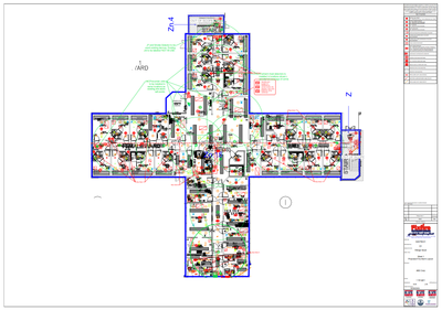

I'm experiencing an issue with a drawing which consists of 3 separate DWGs xrefed together.
The 3 DWGs are as follows:
  • BUILDING GND - this is the base building layout
  • FA GND - This is a drawing specifically for fire alarm information
  • Gnd Zone 1 - this is the drawing that pulls the other two drawings together and has layouts for printing.
I have 2 layouts on 'Gnd Zone 1' which I want to plot.
The first layout is to show the permanent fire alarm system, and there are certain layers on the xref files which I want to plot and certain ones which I don't. For example, I don't want the layer 'FA GND|Fixfire - Westwood Temp Devices 2025' (which is on the FA GND dwg) to plot on this layout. Therefore, I've VP Freezed this layer in this layout. However, when I actually plot this layout to pdf, the 'Fixfire - Westwood Temp Devices 2025' layer is still visible.
The second layout is to show the temporary fire alarm system, and again there are certain layers which I don't want to plot such as 'FA GND|E674G4-FA-ZONES', and 'BUILDING GND|GAPL E-COMMS'. Again, the layers which I don't want to plot are coming out visible on the pdf.
See below screenshots:
Layout 1 - what it should look like (magenta layer is a non-plotting layer):
Layout 1 - what it looks like when plotted - green mleaders and symbols shouldn't be visible:
Layout 2 - what it should look like:
Layout 2 - what it looks like when plotted:
To summarise, it seems like all xrefed layers are plotting, regardless of whether VP Freeze is selected. I only want the layers which are not VP Freezed to plot on the respective layouts.
See attached DWGs.
Glad of anyone's suggestions on this.
P.S. I have found a workaround, which is to open up the xrefed file and actually turn off the layers you don't want to plot. But this is a pain, because you have to keep turning layers on and off whenever you want to print a different layout.

RSomppi
What is the value of VISRETAIN? It should be 1.
srwYB8P3
Ah, my VISRETAIN was 0.
Great, after changing this to 1 and going back through the layers and VPFreezing the ones I didn't want the issue is resolved. Thanks @RSomppi.

@srwYB8P3 Unreconciled Layer notification is an alert you've set to let you know when new layers have been added to your XREF (and likely will not plot with VISRETAIN turned on).
If you feel you never need to know that ever (most of us would never do that), you can turn off the alert/reminder with...
