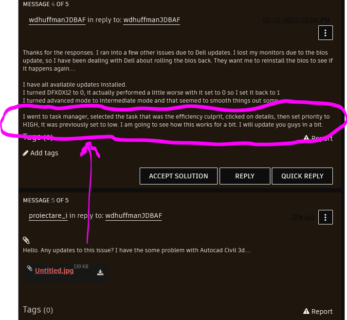

wdhuffmanJDBAF
Thanks for the responses. I ran into a few other issues due to Dell updates. I lost my monitors due to the bios update, so I have been dealing with Dell about rolling the bios back. They want me to reinstall the bios to see if it happens again....
I have all available updates installed.
I turned DFXDX12 to 0, it actually performed a little worse with it set to 0 so I set it back to 1
I turned advanced mode to intermediate mode and that seemed to smooth things out some.
I went to task manager, selected the task that was the efficiency culprit, clicked on details, then set priority to HIGH, it was previously set to low. I am going to see how this works for a bit. I will update you guys in a bit.

proiectare_i
Community Visitor
Community Visitor
Hello. Any updates to this issue? I have the some problem with Autocad Civil 3d....

wdhuffmanJDBAF
It seems that all that is available is finger pointing as to who is to blame.
I have learned to go to task manager, select AutoCAD Application so it displays sub applications.
At the bottom (at least on mine it shows webview2:https//installed-components/Autodesk blah blah blah, it will show the leaves to the right of it.
Select this line then right click. Select details this will open the details pane and typically it will show a highlighted line of text listed as:
Msedgewebview2.exe PID 27652 (yours may differ) description:AutoCAD (whatever variant)) Application WebView2: https://installed-component ..........
Right click over this line and select "set Priority" change this option from "low" to "high" I have not tinkered with real time yet.
This seems to help, try it out and let me know if its helpful for you.
