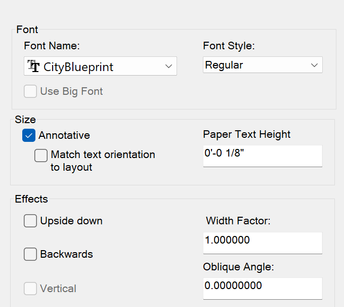

Below is the text style I've created as shown in the Text Style dialog box.
Below is a sample of two MTEXT. The bottom one I double clicked in the text box and changed the formatting to bold, as you can see it didn't make a difference.
So, what I get from this thus far, from what I've seen and the responses, is that with this Font I can't control its boldness.
Is there another font that is similar to this that I can't change the boldness of? Like a SHX file that CADffm mentioned?
Thank you for your responses again.

@Anonymous wrote:
Thanks for the responses.

No I don't see a bold option as shown below.
That is how it looks for me as well on the layout screen, but when I plot it out it doesn't appear like that but instead how I showed earlier.
Thanks I'll check out that link.
