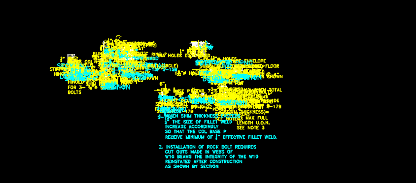

I have multiple details and scales in model space. When i change from one scale (eg 1/4 = 1'-0 to 3"=1'-0") the text and dimensions on the other different scales get bigger and the mtext with a leader on some jump all over the place. I always set my dims and text to "annotate". What is causing this and how can i fix it as this could be a problem in paper space when i notice some of the text and dims intrude in other view ports. So far to fix i set the drawing scale in model space to 6"=1'-0 when i am done and this reduces the problem from over lapping into other details. Thanks
One is 1/8 = 1'-0 and the other is 1 1/3 = 1'-0
This is what happens when i go from a small scale to a bigger scale. Thanks

h_s_walker
Make sure the icon ringed in the image below is not selected (not blue) and your problem should go away. It's for showing all items at all relevant scales.

excadman1
AWESOME. THANKS
