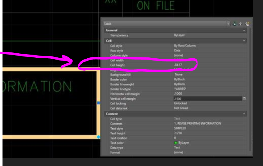

I've noticed that when increasing the horizontal and vertical margin of a table cells in AutoCAD LT 2018.1.2 O.161.0.0 by using RMB properties, the cells update and show the change after committing.  However, when decreasing the value back to zero, the cell stays as is.  This behavior is the same in AutoCAD LT 2019.  Is there a way to force the cell back to zero margin?

I attach the sample file for you to try out.
Please try to decrease the horizontal and vertical cell margin to "zero" or any lower number than .100 and .150 currently.  Does the cell margin shrink to your set value or stay as is?
You can always increase these values and the cell margin will grow accordingly but it doesn't shrink and seems to be locked in if you decrease them.

Looks like you are simply ignoring the CELL HEIGHT setting for the row
Which would get you what you want correctly

I always start (and usually go no further than) with Cell height to achieve the same results: after that "margins" can come into play if you need to give more room to more text in a cell (like your last rows). But then, why wouldn't you just use the Cell Height setting again?
