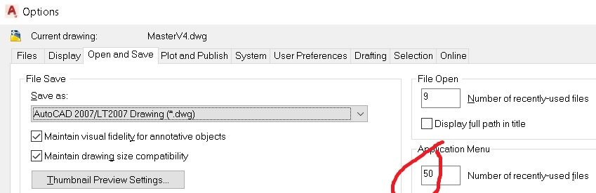

Is there any way to adjust the number of documents you can pin in the "Recent Documents" list on the "Start Tab?"  Or is it hard capped at 9?  I don't think you can expand the number of files shown on that list, so pinning anything more than that would be impossible, I suppose.

You can increase it to 50 from the options dialogue "open and save" tab

I had changed that setting, but didn't realize that it applies not to the start tab, but to the list of "Recents" in the home menu or whatever that button is called.
Good call!

But what about on the Start Tab - is this limited to 9 max?  got a lot of spare space to have more showing - 28" 4k screen.

9 remains the limit: but you can bypass the startup screen and have AutoCAD/LT start with the OPEN dialog which you can customize etc. Ready for the switch/change?

Refer attached screenshot

It eventually updates in the Start Tab as well.
