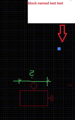

Hello all, ive saved a block into my library so I can insert it into other drawings. The problem is, when i insert it, it inserts extremely zoomed out. I try to zoom in but model space is not able to zoom in that far.

Well I figured out the ribbon thing. Thanks for the reply again. Ive attached a screen shot of th problem im still having of the block being way to zoomed out. Id like to add, If i start a brand new drawing and insert this said block, it shows up just fine.. it only happens in the existing model that im on. I know i can just start a new drawing but id like to know what the hell i did in that certain model space for me to be having problems

Measure this, I think it is much to big (unusual) and because of this, all other stuff looks tiny. User command DIST<enter> to explore your dimensions
And yes, if you are using a very very large area in your .dwg or an area billions units away from WCS 0,0,0
you get trouble.
X=1913300000000000000000000.0 Y=2653800000000000000000000.0 Z=0,0
is way too far away and some objects looking too big.
