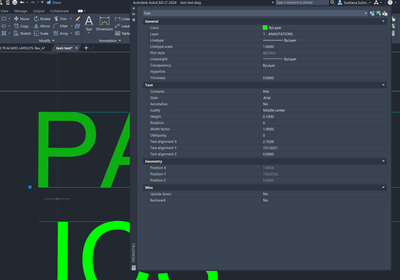

syanchuck
I don't see any "Text Orientation" under this Text object Properties:

syanchuck
Thank you very much for your solution.
In my understanding, the reason why I could not change the angle of the text is that was not enough number of decimal units.
After I did maximum of the units, it let me make all text angles equivalent to zero.
