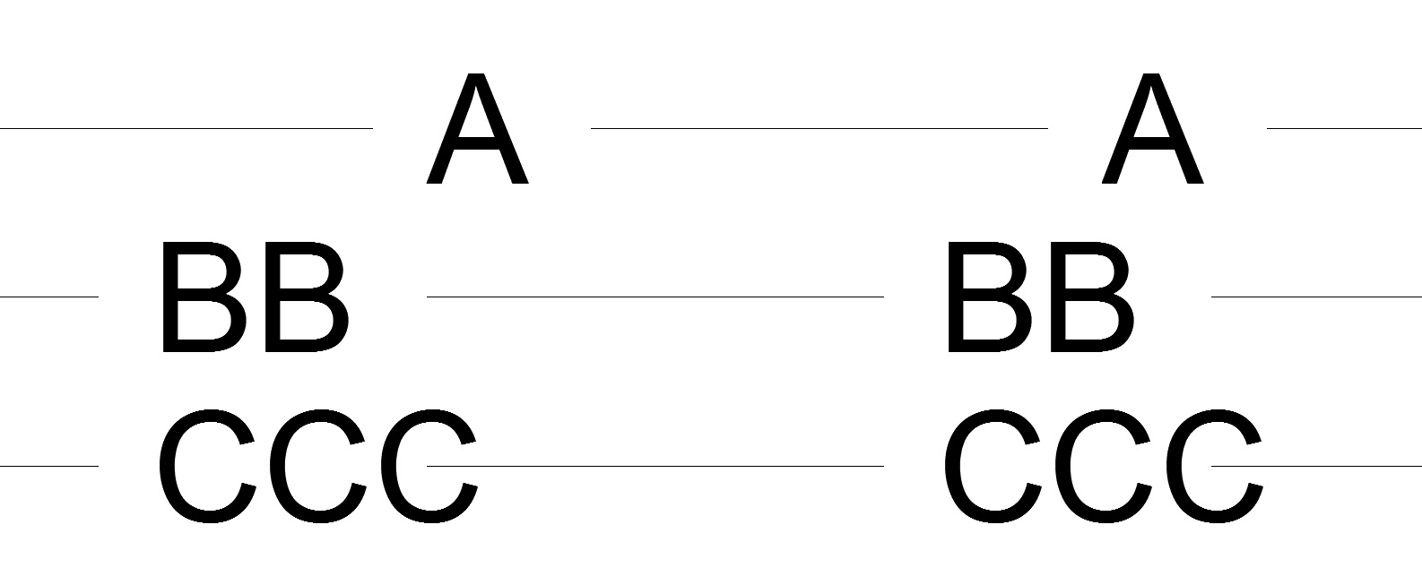

Is there another way, for those of us with OCD, to get the gaps to match (see my samples attached) using AutoCAD 2021 LT?

Here are some linetype samples created using Sam Lucido's LineSanity theory:

According to Sam, the distance/gap between the last character and the start of the line should be .12 units X the number of characters.  So, linetype "A" should have -.12 as that value, linetype "BB" should have -.24 as that value, etc...  With that said, I count every character & space and multiply that number by the .12 units to give me the value at the end of each linetype.
In the attached dwg, you can see that .12 units theory works for ABBCCC but does not work so well for IGN (R-S)IGN (RUN) or IGN (START).

Forgive me, so is the problem you're just tired of testing and retesting your code? Or something else? I assume you don't like the larger gap after the longer text, yes?
The gap after the text is controlled by the last bit of code, if -1.08 and -1.32 are not working for you, then change each until it does
For example that -1.32 looks better here at -1.18 to me, but you decide for sure.

Yes, that is correct Pendean.  Guessing the gap's value is annoying.  I know its not the end of the world to massage those numbers until it looks right, but that MKLTYPE command is perfect for those of us with OCD who need perfect symmetry 😁.
