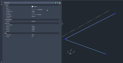

Just in case it could be useful for someone else: I had the same issue, where two polylines had the same apparent properties, but the one I'd apply the "MATCH PROPERTY" to wouldn't change. The difference between the two was that the good one was a normal polyline (a 2D one with an elevation applied) while the other one (the one that didn't work) was a 3D polyline. Once I transformed the 3Dpolyline into a normal polyline, the properties were immediately applied.
Does someone know how to apply different linetypes to 3D polylines?

@mathilde.predella This is the LT forum, LT has not ability to edit 3DPolylines, and as far as I know you cannot apply linetypes to any 3DPlines.
Ask in the correct forums if you want to explore more.
