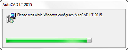

Thanks for the update. I will move your message to the AutoCAD LT forum as that's the best place to post AutoCAD LT questions.  But before I do that, I'll answer your question.  I actually wrote a batch file years ago when I was working on the AutoCAD Team that will re set all your settings back to the out of the box settings.  We ended up rolling that into a feature for AutoCAD and LT.   You can find it under Autodesk/AutoCAD LT 2015 and it's called "Reset Settings to Default" Here is a screen shot that shows where it's located.
Hope this helps get you back up to orginal settings in AutoCAD LT.  And good luck with the tutorials.  I'll move this to the AutoCAD LT forum now. Also here is the direct link to the AutoCAD LT forum.
