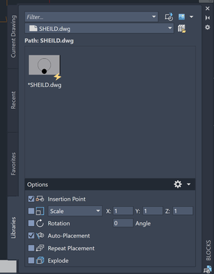

I am trying to call old Block Menu that I am more comfortable with already long time, however nothing works.
I don't like this Menu:
I want to see the list of all internal blocks. Also, I want to insert the block at the certain insertion point, not drugging it into my drawing, then trying to put it at the proper place.
Anyways, how I call that old menu?

cadffm
1 .it's the INSERT (Blockreference) dialog
2. "I am trying to call old Block Menu"
     See above to Pauls answer, CLASSICINSERT [F1]
3. "I want to see the list of all internal blocks"
     Turn on the green tab and in the upper right corner you can switch between Text only, Text with Symbol a.s.o.
4. "I want to insert the block at the certain insertion point"
    This is the red option. Your current setting (enabled) works this way.
m.M. you should learn the whole power and possibilities of this new palette,
only this way you are able to deside when it's better to use the old dialog, or this powerful tool - it's MUCH more than the old one in a new design.
Sebastian
