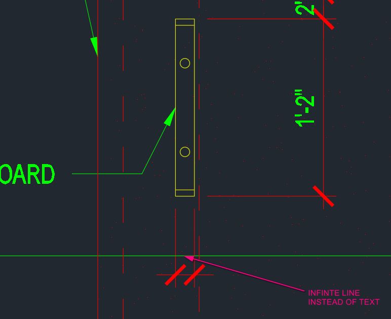

I opened a file today and it seems that some dimensions have an infinite line in place of the dimension text. It doesn't seem to be annotative related. I'm stumped on this - any help? 2018-11-26_152645.jpg2018-11-26_152725.jpg

I'm still having this problem, stumped on a solution. I can't even draw new dimensions without this infinite line appearing where the text is...

That's correct, I'm using DIMLINEAR command. DIM command does the same thing.
Turning off LINESMOOTHING and resetting AutoCad settings didn't work either. Now I've lost all my custom workspace settings - how do I restore it from the backup Zip?

I think you're right, it's the Dim style. It's become corrupt - other styles work ok. How do I fix this?
Message 11 of 11
thomas
I FINALLY figured out the problem.
The text style that the Dim was using was Arial Narrow at 0.75 width. I changed the font to plain Arial and it fixed the dimension. For some reason AutoCAD 2019 doesn't like Arial Narrow...
