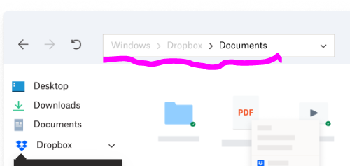

pendean
in reply to: mklancicABX8U
all of your DropBox folders and files are stores on your PC here and that is where you use OPEN command in LT2024 to get to them (where I scratched my name out is where your PC/Windows login name goes)
You can double-check that location in your DropBox app
