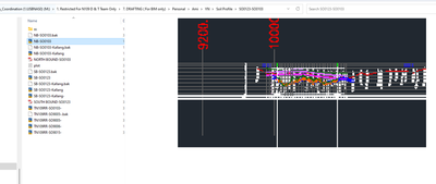

We can open and edit the cadd .dwg file, after saving the file (e.g. SB-SO0123-Kallang-), we can see the updated image from the preview. But when we are trying to open the file, the errors appeared and even when trying to recover the file, it can be recovered.  we cant close any cadd file as we are afraid of losing data.

@ning.yuWGMA7 If you never knew it before today, the preview image is just a static raster screenshot that is buried in the DWG file. There is no live-view of a DWG file, that's  fallacy you need to dispose of quickly. previews literally mean nothing when it comes to file health.
Autodesk offers this long list of ways to try and access damaged files, explore at will https://www.autodesk.com/support/technical/article/caas/sfdcarticles/sfdcarticles/AutoCAD-File-Corru...
Your posted very small 293kb sized DWG file (that's too small for the image you posted IMHO) has 4 errors according to AutoCAD/LT 2023's RECOVER command but never opens. Sorry, this file is lost to eternity now.
Start looking for backups of that file (you should be backing up all of your files daily and weekly and monthly, yes?) as well as possible AutoCAD backups as explained here https://www.autodesk.com/support/technical/article/caas/sfdcarticles/sfdcarticles/Understanding-Auto...
Sorry for your loss.

Looks like the dwg is beyond recovery. Use Windows Explorer & rename the problem file to something matching file name with -bad.dwg and then look in the same folder as drawing for a file matching file name with .bak extension and rename this to the actual drawing file name with .dwg file extension.
See if now you're able to open this older drawing file with data.
If this save file corruption to the M: drive happens often specifically with this computer, you should investigate all the network components that connects the computer to the network M: drive such as:
computer's built-in or added network card/port
network cable connecting computer to the data port on the wall
the data port on the wall itself
the port location where this data port connects into the server room
