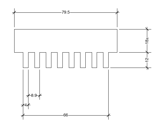

These are the types of dimensions you need to draw a comb, in autocad or by hand with a pencil:

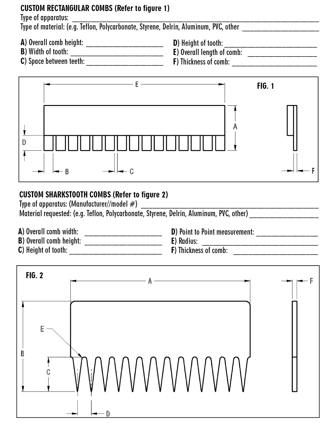

I am drawing this in 2D for now, until I can take a few AutoCad courses and develop some skills. As for the comb, I have a prototype comb in hand, and I want to draw it so I can create new designs etc. I did see some instructions for taking a picture, and importing it to autocad so that you can trace on a new layer. That might work, but it would be easier to make multiple teeth at once with the proper spacing, maybe a parallel line command?
Message 7 of 10
I didn't know there was a custom comb ordering form....

There is a form for everything 🙂
Anyway, that's the kind of information you really need before you can start drafting, cad or paper: tracing over a picture might be fun for a little while but accuracy would be lacking for such a repetitive task like comb teeth.
