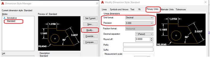

@jacobNFVKG Looks like your dimension overrides are being removed or your dimstyle is getting updated to match the predefined DIMSTYLE settings in that DWG file.
Can you share your actual DWG file with that content in it here?
paullimapa
goto that dimension style using DDIM or DIMSTYLE command select that style choose Modify and match following settings
