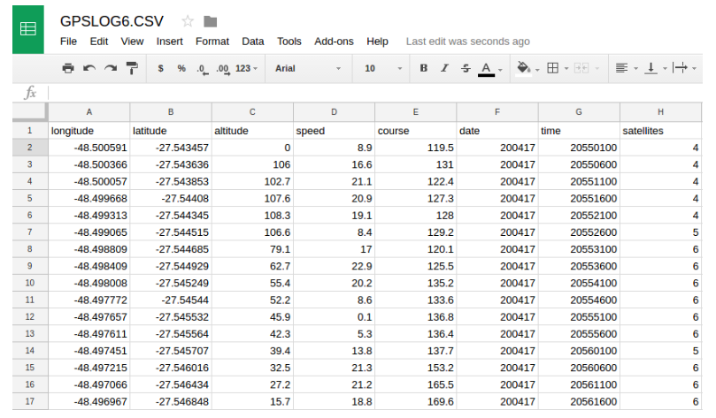

Ok, I attached a .csv file as a sample.  The files would need to be as accurate as the coordinates being given.  The survey areas are maybe a few thousand feet/meters so the curvature of the earth is not important.
Message 12 of 36
steven-g
Autocad LT is a general-purpose drafting software, and I'm definitely a general-purpose user, so you would need to help me here, what is that data how are you supposed to read it, if this is geolocation data the best I can make out, places me in the Republic of Karelia in Russia? or South Sudan depending on where you place the decimal? But I would hazard a guess at the first column being just a point label,
2nd the X value or northing but is that (meters, yards, feet millimetres?)
3rd the Y value or easting
4th the elevation/altitude?
and finally a location description
It has been some fascinating reading over the weekend, and Autocad LT does use geolocation data and also a special type of geometry 'position marker' and it will also work with latitude and longitude display.
So what does that csv data represent?

Here is an easier file that I
Message 15 of 36
steven-g
LT will accept latitude and longitude coordinates, once a drawing has had a geolocation marker set. But it will only use those coordinates when using the '_geomarklatlong' command which places a special type of point that also has a leader and label, and unfortunately, it looks like that cannot be done from importing data, but rather by entering the latitude and longitude coordinates one at a time, you can save some typing by getting Excel to create the command and enter the coordinates, but you will have to still enter the label details by hand for each point you need to place.
