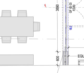

I have furniture blocks on my drawing that I want to add transparency to them for the wall setting out set of drawings.
I have all blocks created in layer 0 with solid hatch, lines are by layer and the hatch to 253 colour.
All blocks are in the furniture layer, which I assume I could add transparency to the layer in the layer properties manager and it would change all blocks to the set transparency.
Is that how it should be?
For some reason it only change a couple of blocks, and none of the dynamic blocks changed.
before
after - changes the line but not the hatch
is there a way to fix that?

@leticia.campanelli Select the hatches in your blocks and then in the Transparency part of properties type in BYBLOCK. See the image below

leticia.campanelli
Amazing!
I didn't know you could type anything other than numbers.
Thank you so much
