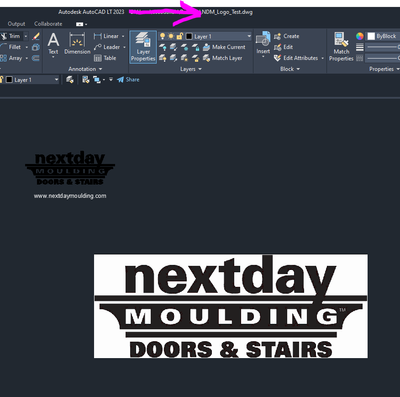

Hello! I read through many web sites on how to add a logo. The original logo was drawn in Adobe Illustrator. I opened a jpg version in Photoshop and copied it and tried all the options under Special Paste. After each try, I dropped the cad file on the web.Autocad.acad.me page to see if the logo "took". Each time I saw the white square with the "Windows OLE Object" text in it. So then I exporting the logo from Illustrator as a dwg file. I inserted the logo as a Block and worked on the color. I am really a newb at this, would someone mind checking my file and letting me know if it works? Message me if I should send you the dwg.
Thank you so much!

Hi, Here is a the dwg I saved using the 2 instructional links. Let me know if you see 2 large logos please.
Message 11 of 14
h_s_walker
@D.Hudson1 The two logos are visible as well as your block

D.Hudson1
Thank you so much for your response, I really appreciate it.
I don't understand why I don't see the logo on my end when sent to a different computer. Maybe I have incorrect settings?
Thank you again.
Message 14 of 14
pendean
Community Legend
Community Legend
No idea my friend, your posted file works like charm here.
