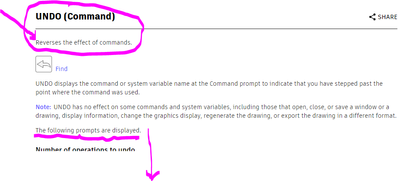

UNDO does this (see below), often forgotten by some users, "editing" is not an option or sub-option but you can explore what it can do further down that HELP page
And you can for sure explore these commands and variables to see what the program as is does today and likely for the near future:
