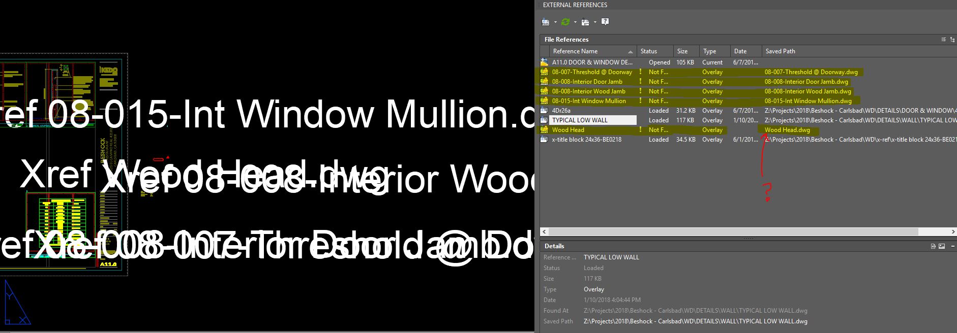

I'm having an issue with my xref saved paths. I work off of a windows 10 pc on a server, along with 4 other computers. Only mine seems to have this issue. Sometimes when I make revisions or work on a file that is xrefed into another, and I save it and reload it on the other file, the Autocad will for some reason change the saved path to the file's name, rather than the file's location path. I've audited, purged, regenerated, you name it to make sure the two files are clean. Still not helping. Also, this only seems to be happening on my computer... and sometimes... so I know I'm missing another clue here. I just can't figure it out. Help please! 🙂

RobDraw
Look closely and you will see that those drawings cannot be found by AutoCAD. That is why the path is changed to the file name. Once the files are located and repathed, all will be good.

Right, that's why I highlighted the saved path. Something happens that causes the path to change from the saved file location. It's simplifying it to the file name alone for some reason. I've resaved the correct path and it will revert back to the file name again. It seems to be happening when I go into that file, make changes, save, and reload updated xref.

The images you show indicate that the xref can not be found. This is likely because a network drive is not obtained or not obtained quickly enough. If this does not happen locally then I suspect you have a network issue.
You can try logging in as a brand new user with administrator permissions and no Group Policy applied from your network. Then launch AutoCAD with no modifications/customizations to see how it behaves.
