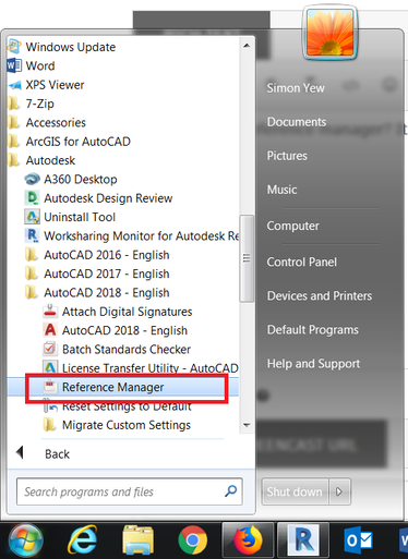

syman2000
Have you try reference manager? It is a quick way to change xref path to multiple drawings. Image below shows you how to edit the path easily. Make sure you press the APPLY CHANGES button so the path will set to the DWG file.
Go to Start>Find AutoCAD folder>Reference ManagerGo to Start>Find AutoCAD folder>Reference ManagerStep to add & edit pathStep to add & edit pathChange Path & you should see green check markChange Path & you should see green check mark
Message 4 of 13
that option is to update the path of the xref im not updating the path i want to change the xref that is linked to the 5000 drawings with a new xref that i have that is in the same path i think im going to give up ive tried everything on goole and i think i cant explain myself properly so no one can assist me to overcome this issue
