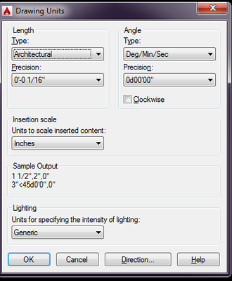

When I attempt to attach this new xref, it keeps appearing about 2" to the left of where I need it to be. I figured this problem has something to do with the units or scale used. I checked both the xref and drawing file's annotation scale (both the same) and the drawing units. Now, the drawing units of the two drawings are different, but when I change then both to the same type and attach the xref, it is still "off" 2" to the left (the same exact way as before). Also, it's important to note, I checked all the other xrefs as well and they all have the same drawing units as the xref I'm trying to attach (architectural--pictured below) and they are all in the correct place.

Both the drawing I'm trying to attach the xref to and the xref had these drawing units:
Command: -DWGUNITS
Drawing units:
  1. Inches
  2. Feet
  3. Millimeters
  4. Centimeters
  5. Decimeters
  6. Meters
-DWGUNITS Unit for length <2>:
> > this is a dumb question, but this means the drawing units is in feet, no?
Also, when I have tried to insert it at 0,0,0 it does not appear anywhere near the drawing (i.e. I'll zoom extents and one is in far upper right corner of the screen and the other the lower left).
I think the distance may be off (I've attached a picture below for reference--highlighted is the new xref) but I'm not sure, just from eyeballing it, it looks like it may be slightly lower than where it should be
 Both the new electrical xref and the original communications xref have the same insertion points as well.
