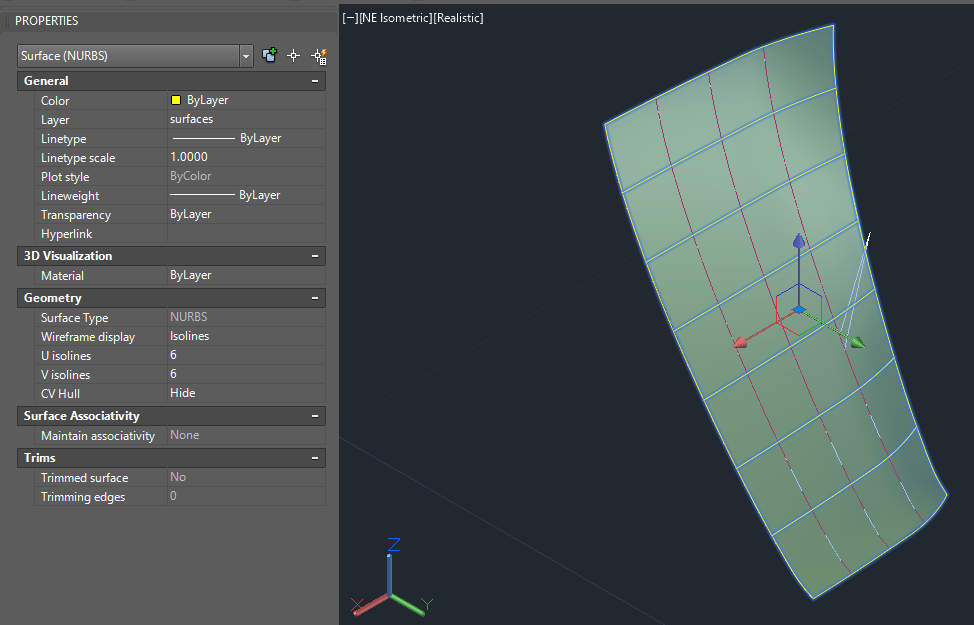

My first question is what is your end goal?  It is to make a pretty picture, do an engineering analysis, make a 3d print, something else?  This will determine the precision you need in the model.
Using 270 points to define each profile is way too many.  YOu should first concentrate on creating a more appropriate model.
I changed "line" to "3dpoly" in your script. I then copied the data for the first 5 profiles into Excel and created a data list using every 18th point of the 270  for a total of 16 points for each profile  and used spline to create 5 splines.  The results can be seen in the attached file.  The original line data is on layer 0 (note the data error at vertices 94 through 97 on the second profile).  Layer splines contains the spline.  Zoom in to see how well (or not) the splines duplicate the line profiles.  I then used loft to create a surface.
Once you have the airfoil defined as more efficient surfaces you can use them to create the watertight solid model by defining surfaces that include an edge of the surface model.
I suggest you make a surface model as I described of the first 5 sections and the complementing  opposing profile and then I can detail how to create the solid model.
Note, here's a snapshot of the Excel file and the formula I used to extract every 18th profile (column D).  Column D and E are copied to sheet "spline data" and then sorted on the value of E to yield the input to AutoCAD.  I just copied and pasted  and column A of the spline data sheet into the command prompt of AutoCAD.  For some unknown reason making a script file of this data did not create all 5 splines.
